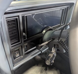

Here is mine....

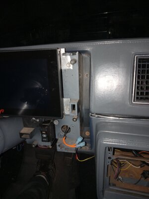

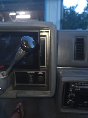

I used the cruz mounting kit . Then modified a bezel. Its not as clean as i would have liked it but it works.

How did you go about mounting the screen ?
I used the Cruz mount for the screen. Let me know if you can't get one from him. I may have another source for those. It's just a 3D printed bracket. You could also make your own.

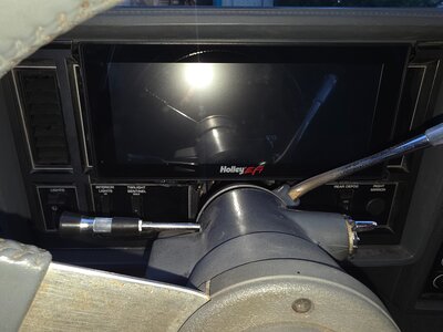

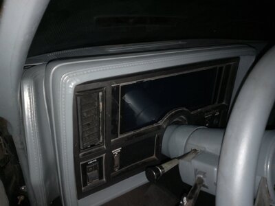

i tried the cruz 3d printed mount a few years back ...didnt work , couldnt install the oe bezel as it made the screen sit way too far out from dash and he wouldnt take it back
, i just cut some squares of light sheetmetal then bent about 3/16 step to get around screen back and screwed it to existing backer plate .
the bezel fit initially just removed the sides but ended up trimming out the curve part around the column at the bottom to be able to see the holley efi logo

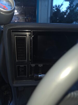

I have the cruz mount. Behind mine but still had to trim my bezel for a flush mount.
