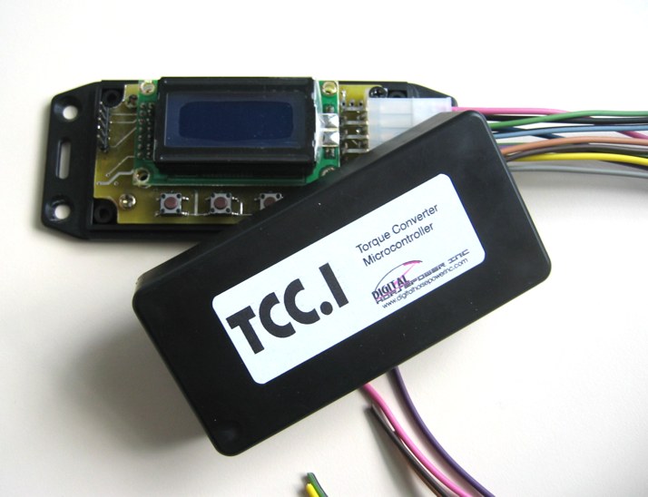

OK, I have about 5 units. 2 are going in cars at White Racing
and the 3 other testers will be getting a unit to try.
We had an issue with the RACE MODE logic and we got
that licked in the code. RACE MODE IS KEPT NICE AND SIMPLE
Set the VSS value for RACE and ground the yellow lead.
As long as you are above 3.8V TPS and you meet the Vehicle speed you specified the TCC locks up under WOT.
Here's updated PICS.

We have an automotive grade FET to operate the TCC solenoid
and a 20 MHZ RISC microprocessor/controller on board.

I have just recieved my beta unit and will be doing some testing soon. However, i didn't like how you have to disassemble the unit to see the display ,and program it, so i modified it so far, take a look!

Yes it would be nice to have a manual, its got alot of parameters to adjust, thats why i put the buttons on the outside

FWIW, there is a Power on switch for the display.
To scroll forward press the R/H touch pad. To back up the L/H one. To change an entry, depress the center button, the variable will begin to flash. When it's flashing you can increase the value with the R/H key, and deminish it with the L/H key. When done hit the center key and the entered value will stop flashing, and then you can again scroll. When done advancing thur the screens, the Save Data screen will flash, again press the center key. The touch pads have a slight delay in them so it may take one or two touches for the touch to register.
Be sure to write down the initial values, so you know where you started from.
HTH
Guys... I just need a few days to finish up the manual!
Basically...
You have 3 buttons Left/ Middle/ Right and they do
Back/Select or Toggle/Forward.
Slider switch is SCREEN power.
THe 1st several screens are obviously status screens.
The Screen that says MAP at the TOP and DG at the bottom
is the diasnostic screen that tells you what the TCC.1 is waiting on to lockup. V= VSS, T=TPS, M=Map, G= Gear, B=Brake. Holding the CENTER button down on this screen tells you what the LAST condition was that caused an unlock.
