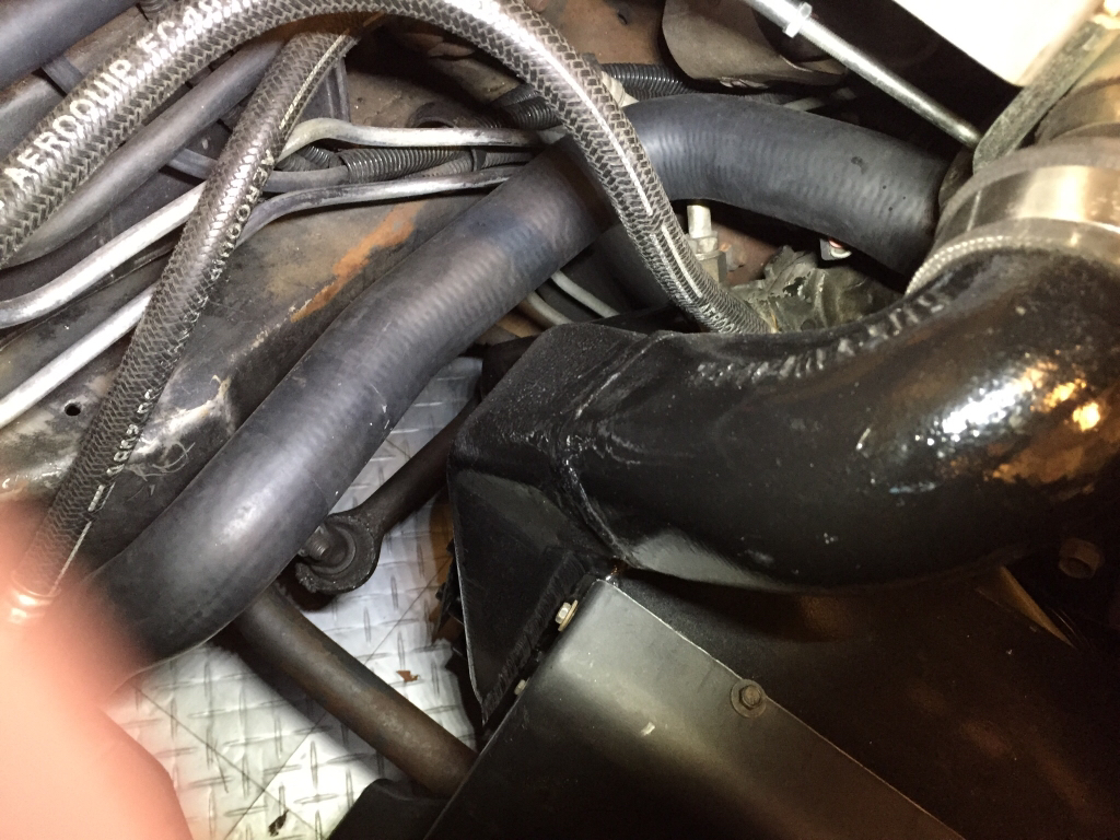

From Rock Auto using original part number as search criteria. It's a DAYCO 71756. The long piece on the bottom of the Dayco doesn't have the little bend in it like the original or Nick's.
This is the difference Turbo T Guy is talking about. My 87 has the correct hose with the bend that does give more clearance near the stock header and heat shield. The heat shield is not on the TA replacement header in the photo. The 86 in the first photo is the Dayco with the stock header and heat shield, it does not have the bend down away from the header.

wanted to summarize stuff in case someone did not want to read all the posts....
'86 and '87 (intercooled) turbo Buicks used lower radiator hose GM 25523616 which is a direct match to Dayco 71756.
'84 and '85 hot air turbo buicks AND the NA 231 V6 applications used lower radiator hose GM 1261444 and 1264041 which are a direct match to Dayco 71083.
The difference between the two hose designs is that the 71756 has a straight section about 6 inches long leading into the water pump while the 71083 has an additional offset bend here. The Dayco 71083 has a displacement length 4 inches longer than the 71756.
The hot air cars did not have an oil cooler adapter or the accompanying oil hoses at the filter so the space occupied by that longer hose is not a problem. Referencing the pic in post 29 by monteperformanc, there is no place to loose 4 inches of hose on the '86 - '87 TBs using the factory oil cooler and stock or aftermarket headers. Lil Truck's 2nd pic in post 33 shows the 71083 installed with TA headers. It only fits because their are no factory oil cooler lines to work around. The offset in this 71083 hose works well to get more clearance to the TA headers but again, won't fit if using stock oil cooler and oil hoses.
