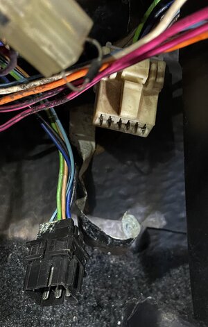

Aloha everyone!
Anyone know what these two connectors are? I was under my dash and found these two disconnected. I can’t find where and if they plug into anything.
not every plug has a mate , plenty of connectors are for optional equipment
the black square plug at bottom is for cruise , if you had cruise it would connect to the cruise harness that comes from the cruise servo under the hood .
the opaque flat plug is for the cruise brain box (little flat square black box) that if you had cruise the brain box would be mounted above the accelerator pedal and that plug would be connected
