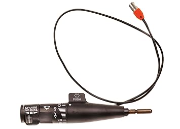

Does anyone know where the black wire on the turn signal stalk with the clip on the end plug into under the dash? Thanks guys Chris
its for the cruise control
a 4 contact blade circuit board (two contacts on each side) that comes from the turn signal arm when equipped with cruise control there will be a square black connector with a clip on the side for that blade to plug into
Thanks a million so where it plugs into is it on the steering column shaft or somewhere close to it black box thank u once again Chris
its bundled into the main harness that has all the strg column connectors , the harness is tapped up to a point above the column and all the wires to column split out to their connectors including the cruise connector with the white lock tab on the side
