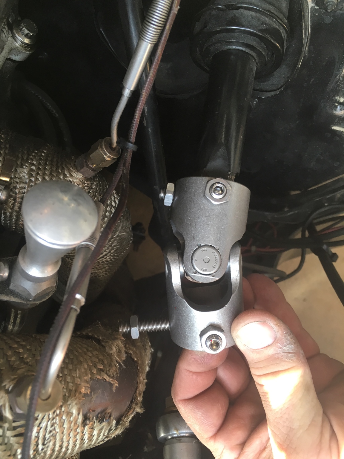

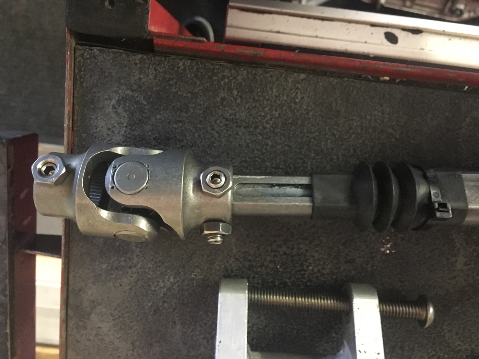

I'm working on swapping to the fast ratio box but it's not a bolt-on with regards to the shaft. The spline count is different. There other standard ratio boxs should bolt in with the stock 30 spline shaft. The only major issue is that Borgeson is in the process of moving there operation to SC so many of there boxs are on backorder. For a standard ratio box your better off finding a cheap used S-10 box with the Pitman arm and save a couple hundred bucks.
This is the stuff I bought for the16:1 box. For a stock box you will need a different joint for the 30 spline box
Borgenson Telescoping shaft 450024 $74.97
Borgenson Universal 115252 $87.97
Borgenson Universal 113449 $87.97
Borgenson Pitman Arm 806019 $89.08
Borgenson Steering Box, Saginaw 525, Manual 16:1 920040 $346.75
