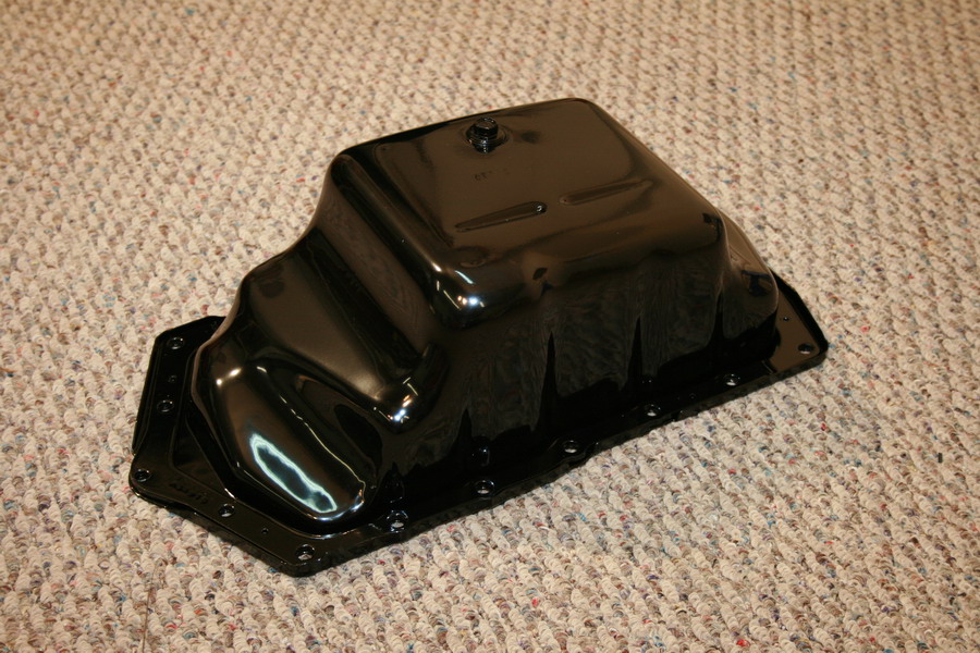

I had the pan done on my 86 recently. I would NEVER coat on the inside of any engine part. Valve covers, oil pan, front cover, and you have to be careful with the intake when powder coating it. Who knows how hot oil and antifreeze over time will react with the powder if you did inside. If done right it comes out nice and lasts a life time. I'm happy with mine. The only thing that sucks when I look under the car I think it's wet with oil!! I'm so use to these Buick's leaking! After spray bombing parts and finding out spray paint only last maybe 2 years before it goes to crap powder coat is the way to go!
Thanks Jim, can you stick that one the box with all my stuff when you send it across the pond :-)
