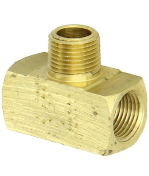

Wonder if anyone had installed a three-way-tee to monitor for pressure ?
Can something like this be installed ?
tee in with pressure switch. you'll have better resolution with a 1000psi gauge - only approaching 600 psi on a pump cycle.
