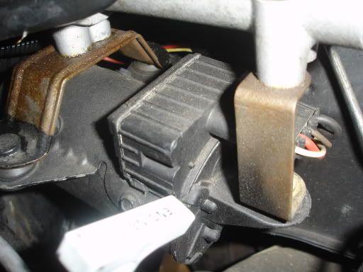

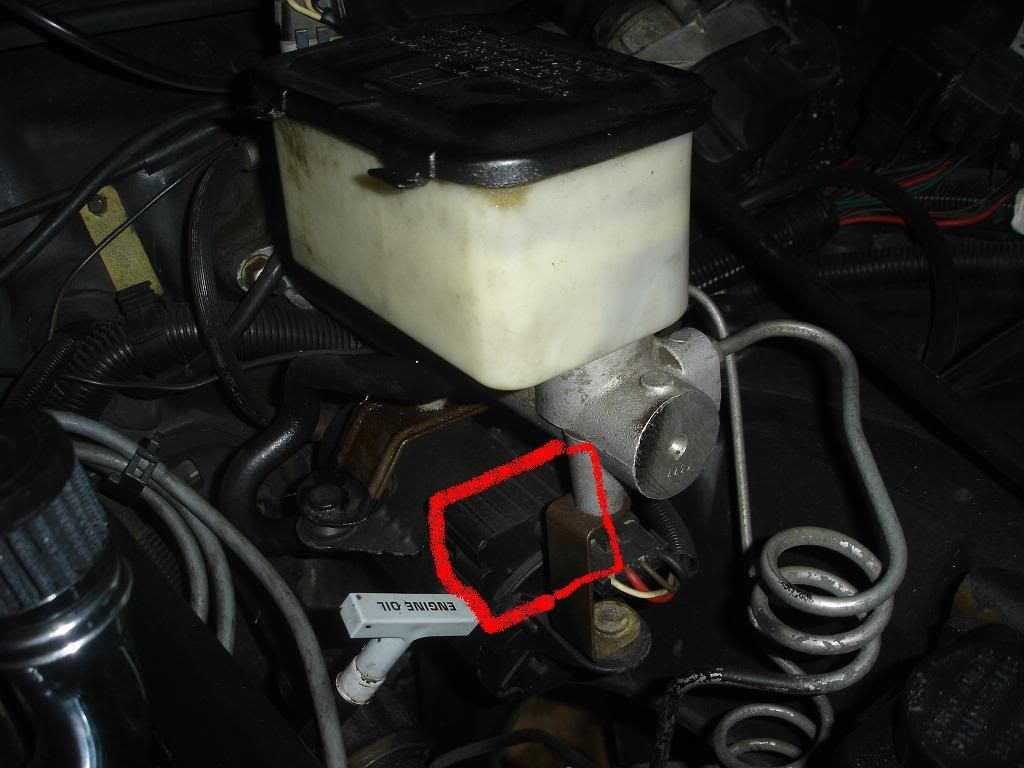

The switches are on e-Bay from time to time and can be picked up reasonably, IF you keep searching and take your time. I have also been lucky enough to fine one a local parts store hanging around so ask and ask again.

I need a pressure switch. Can you tell me where the $18 switch can be found?

I don't know where he's finding those either. The one's that pop up on ebay on occasion generally end up going for abou 70-90 bucks. Somebody tell me where i can get an authentic switch for $18 and I'll buy a hundred of them.
