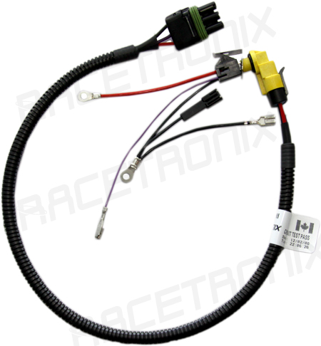

The pigtail that you include with Walbro pumps that connects the pump to the bulkhead connector...what gauge wire is used?
Also your G77ITWH kit found here, it says it fits "most" Walbros...does this directly fit the new Walbros you sell? And is this just the piece between the bulkhead and the pump? Or is it that plus the piece from outside the bulkhead to the plug in connector pigtail under the rear bumper?
We use 14 AWG Teflon jacketed wire. This is the largest gauge of wire which we can crimp onto the Delphi 150 series terminals w/o complications. The resistance of this wire is very low given its size and very short length.
The link above is for our BCWA-G7U. This KIT includes the outside wiring, bulkhead connector AND in-tank harness of your choice (chosen w/drop-down menu) depending on the type of pump you have. Our G7-ITWH kit in the drop-down menu is our G77 version which fits all Walbro GSS-series high-performance pumps.
