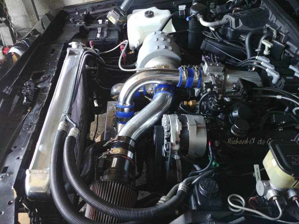

Just an fyi, this is what was needed done to the rad support on mine, you'll notice about an inch or two shaved off at the hood lock area. Is a deal breaker for some.

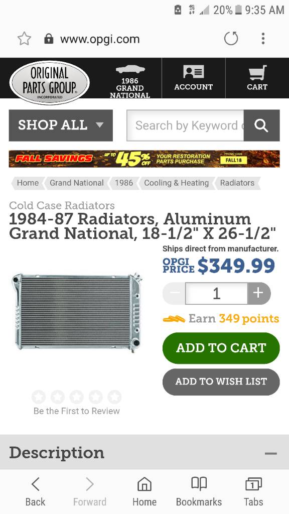

I bought one of the radiators that Rock Auto sells for our application made by APDI and it configure correctly. The fittings on the transmission cooler connections are wrong and even if you can source a fitting which I did there isn't room between the fittings and the A/C condenser core. Don't buy one you won't be happy. The only possible application for the APDI radiator would be for guys with no A/C. I ended up buying the Cold Case radiator, it's a very nice piece.

i used the kirbans intrepid fans with a casper harness, they all plugged in together with the factory harness seamlessly. i have a stock location stretched IC, i have heard some running front mounts have issues with the pipes. will look for a picture with it together if i can.
