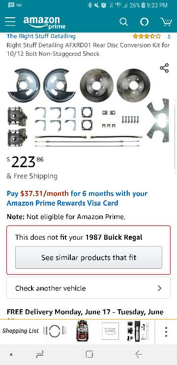

Right Stuff Detailing AFXRD01 Rear Disc Conversion Kit for 10/12 Bolt Non-Staggered Shock https://www.amazon.com/dp/B009NRB316/ref=cm_sw_r_cp_apa_i_TfE7Cb8RVTN82
I found this kit for cheap. It says it won't fit, worth a shot?
According to these threads, that doesn't look like the correct kit for our cars.
Thanks! I figured Sorry for using you as the search bar.
The kit looks decent, if you happen to have a need for it.
No problem. I remembered reading those threads so it didn't take long to find them.
