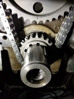

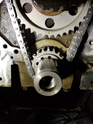

Mar 20, 2020 #2 hflwyo Active Member Joined Jun 5, 2007 Messages 281 Here are some pictures of mine installed straight up on 0 degrees. I will look and see if I still have instructions. Attachments 20180204_125232.jpg 1.3 MB · Views: 170 20180204_125223.jpg 1.5 MB · Views: 155

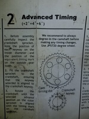

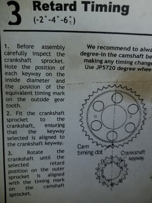

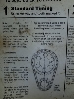

Mar 20, 2020 #5 hflwyo Active Member Joined Jun 5, 2007 Messages 281 Incase anyone else needs them. Attachments 20200320_150229.jpg 1.6 MB · Views: 158 20200320_150235.jpg 1.4 MB · Views: 172 20200320_150244.jpg 1.4 MB · Views: 152
