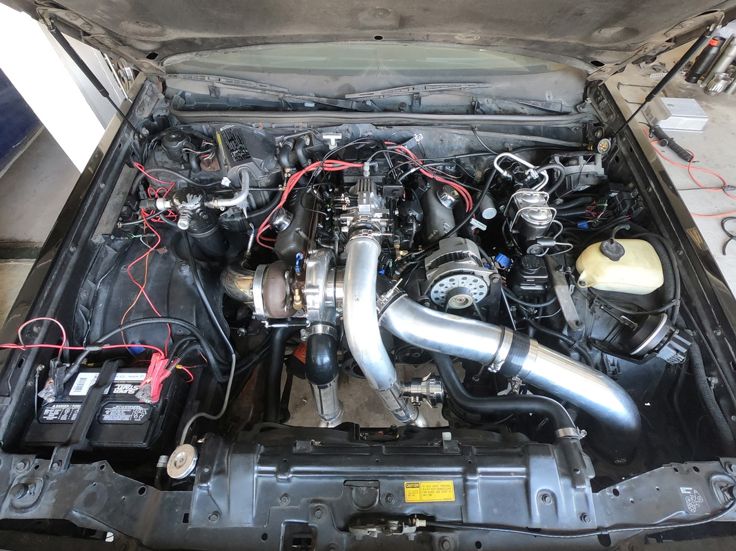

got a pic of the engine bay, still need to clean up some wiring and clean the tires/wheels. Next weekend is the exhaust! Doing a 3."5 TA DP/test pipe into a Pypes dual 3" with Flowmaster 10 series single chamber. No cat, waiting on my Montana Plates :)

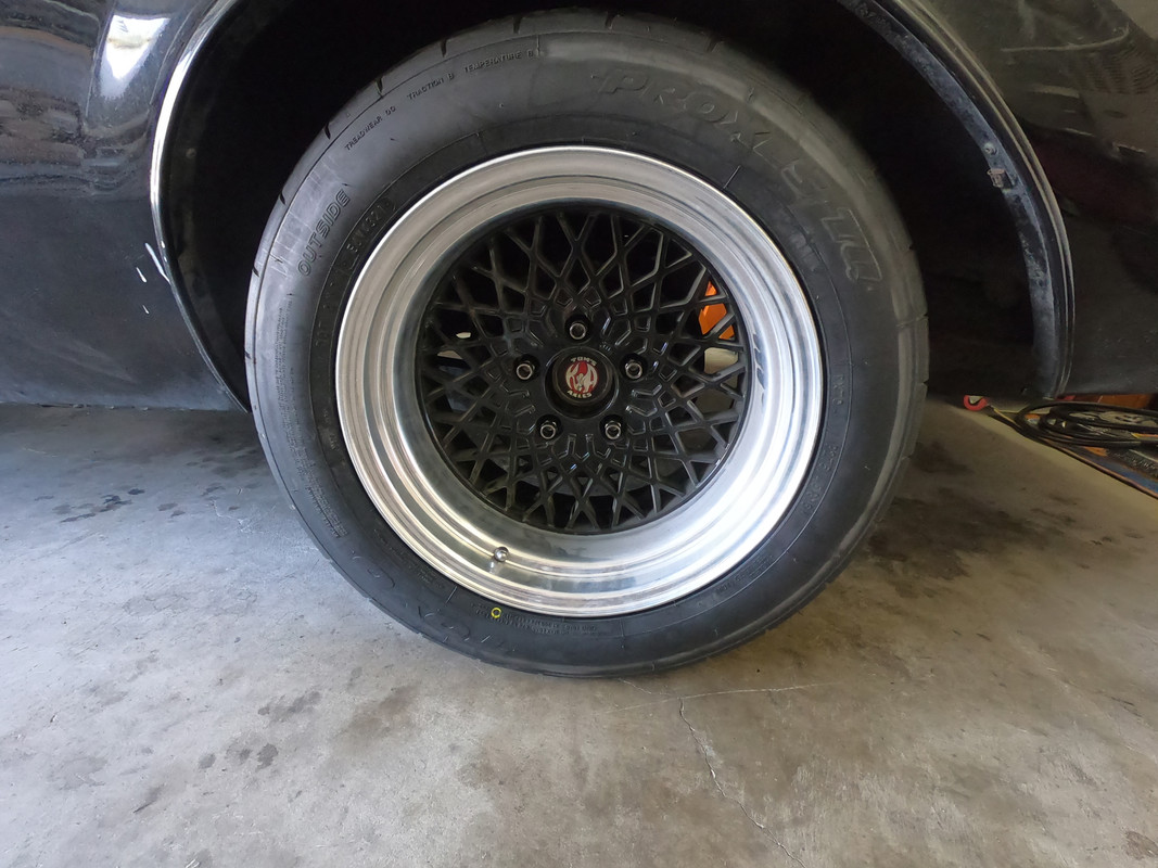

here is a pic of rear wheel, riken 16x9.5 custom offset cut the center out and rewelded it/powder coated/polished
sitting on a toyo proxes tq drag radial 275/45/16
