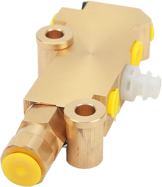

Reading on these proportioning valves. I bought a brass one several yrs ago and put a search in on the ebay and came up with something like this.
Not sure what it is made out of but as it is silver in appearance I don't think it is brass. Has anyone taken the jump and tried one of these? Made of chicom but for $26 plus tax it seems like a viable option. The brass ones I'm sure come from over there too so I don't think that is a down side so much.
Anyone have some feedback? TIA
worth a try or spend the money on a brass one? I don't have the road salt and such like a northern climate might. but for a few extra sheckles I'd rather spend the money if the brass has a better record . I know the original iron one I took off my first one was pretty corroded inside.

The valve you presented is definitely made of aluminum, almost most of such parts are made from aluminum by the Chinese. Additionally, I wouldn't worry about whether it is actually made in their country, but I would recommend one made of copper, as it is probably better in terms of strength and durability, which is a big advantage.
Pretty sure he means brass.
So we have one in the stick to the brass unit column.
