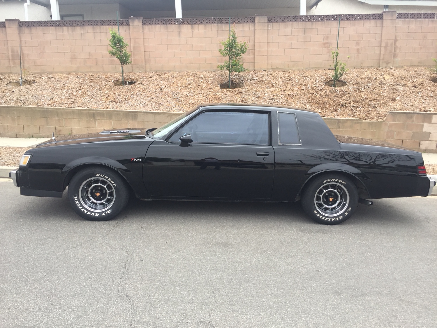

They were old Dunlop GT qualifiers. Don’t know how old. There were on car when I got it. Probably 8+ yrs.
Just ordered a pair of MT Sportsman S/T and will flog a spare set Nitto Drs while I decide if I like black walls.
Here what it looks like now.
