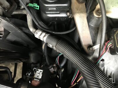

Mikester,
Is this the T junction you were referring to? (closer to the bottom of the picture) Sorry for the crummy pic.

Mikester,
So maybe. I am assuming the conversion you are talking about is to the hydro boost brake system. I have employed a PSC reservoir to manage the hydro boost and have found it acceptable.

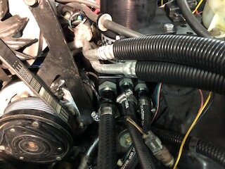

Lot's of info just been part of the up grades to get rid of the wine
The PSC has three ports to reduce the wine
No Tee in the line
But Pricey
