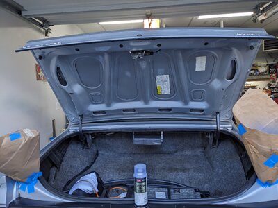

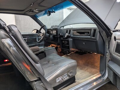

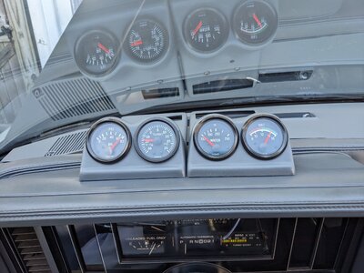

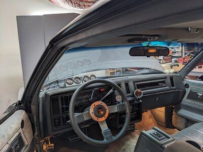

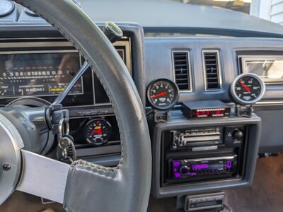

Hello. Thanks for your reply. To be clear, I never said I was checking voltage at the starter solenoid. I said I had my meter at the battery terminals. I did not state that I had "disabled" factory alarm," also previous owner's "aftermarket" alarm, my bad, it was a "rat's nest!" By the way, I have both images you sent, plus a couple more. The problem is, they are kind of vague. They tell you what "splice" to look for, for instance "S200." And where it feeds "C-100" [bulkhead connector," but does not go into more detail. Anyway, I think I know what the problem might be. I have a lot of gauges in the car. Plus, an aftermarket stereo system with an amp, a subwoofer, and a disc changer located in the trunk. As I stated earlier, the person I spoke to before I posted my question said to check "C-100" connector, which "fuse link "A" goes to. I think I inadvertently disturbed the connections while pushing all that wiring up under the dash, so it wouldn't be hanging down. I believe the term is "Wire Management." I plan on lowering or removing steering column to install switches as I said in my first post. As far as being clearer as to what occurred during cranking, it made a couple of "faint sounds." I guess you would call it clicking from solenoid, I don't know. All I know is that when it makes that sound, it means the battery does not have enough voltage to turn the car over. Not only are the "grounds" very important, but also the battery being "fully charged." Infact, I purchased one of those "jump packs." I had to use it once. Also, the battery is new and has been "load tested." Also, I have a brand new "Mini Starter" from TA Performance. I try to eliminate the simple things first. thanks for your help. As you can see, there is a lot going on here. What you don't see, is all the wiring involved here. Also, I just remembered, I don't know if you can see it in the first image, but I installed "power mirrors." The control is sitting on top of center consol. I took it out of an '87 Iroc Camaro, with the full harness and both outside mirrors.
