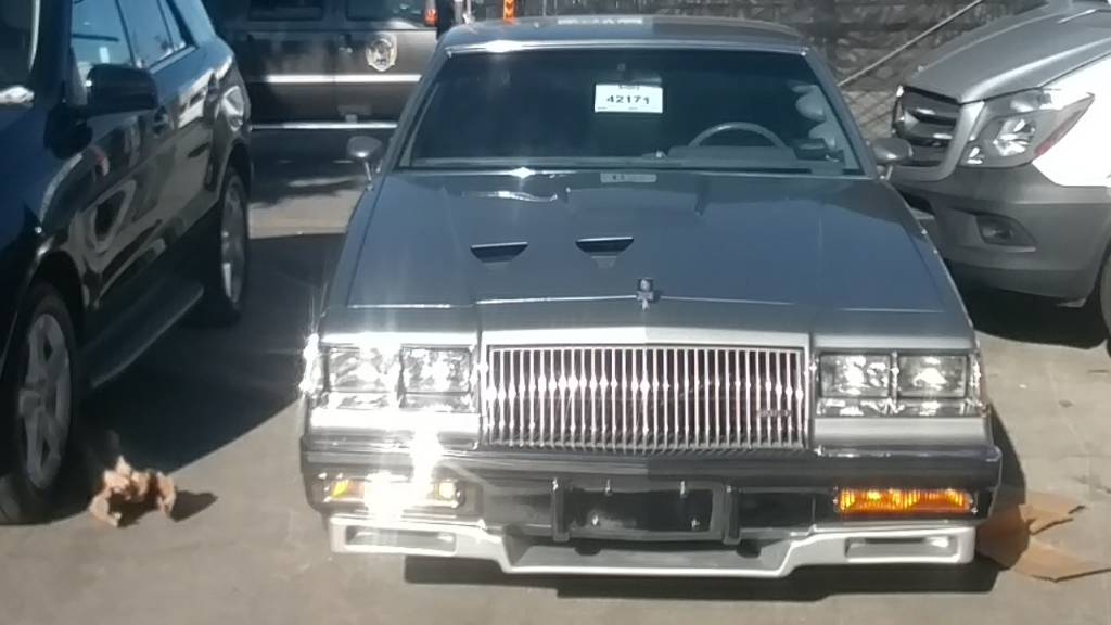

Mine is an old Kenne-bell version bought in 1988. It has a fiberglass panel that attaches to the bottom of the car first, then the air dam/ scoop bolts to the car making a large funnel to the I/C shroud. KB said when used in conjunction with their I/C fan shroud (a fiberglass shroud that attached to the backside of the I/C) it kept the I/C cooler giving you 10hp. That's what they said anyway.
Mine is unpainted black gel coat.
Disregard the unpainted passenger side parking light/ driving light bracket, its painted now (it was used to show what it would look like in a chrome bumper).
They made a version that was built into a fiberglass bumper as well, all one unit.
