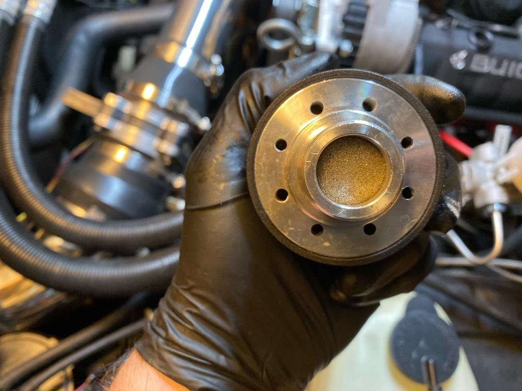

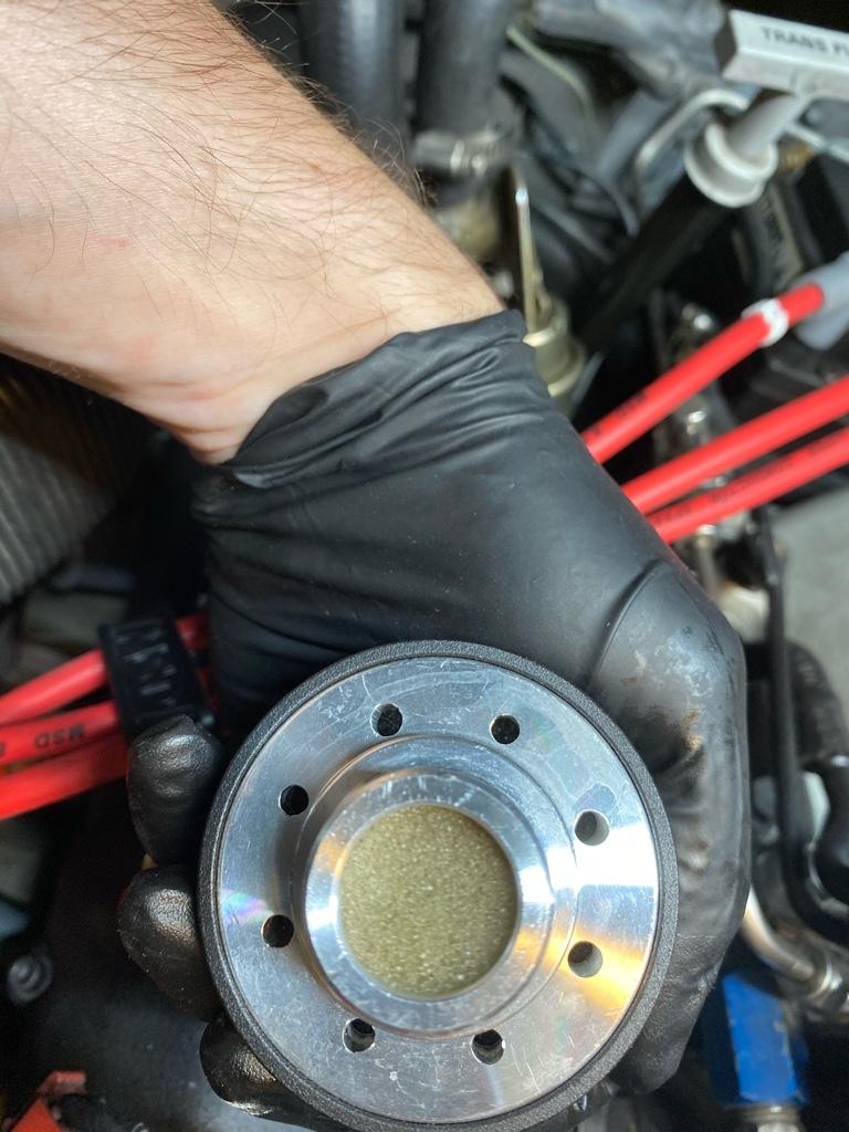

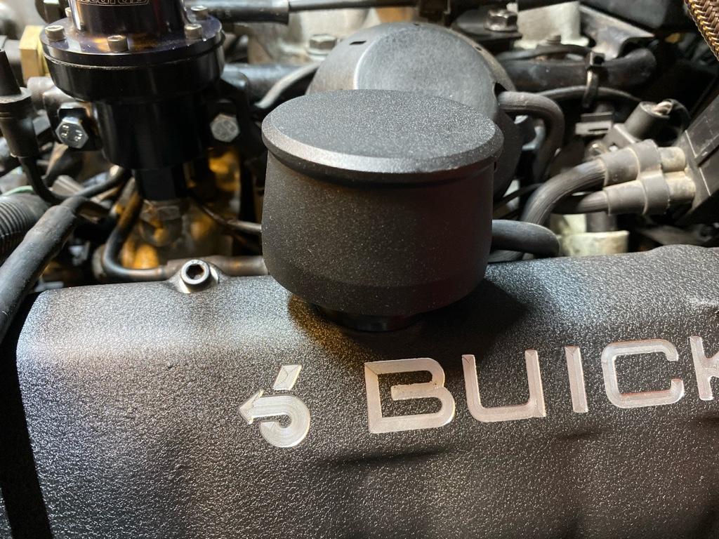

Post pics of all the breathers, and the entry side of the breathers.
Looks OEM.
If it's not kinked, that's not the problem.

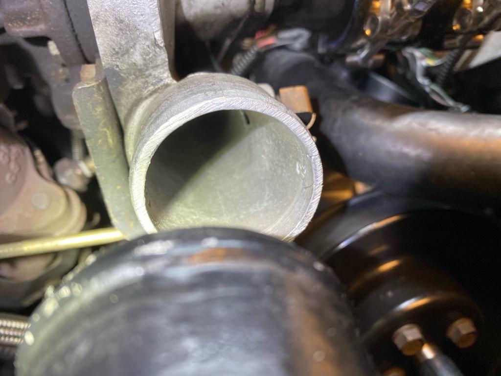

Appears to be clean going into the intercooler
Downpipe appears to be clean
Driver side breather
Passenger side breather

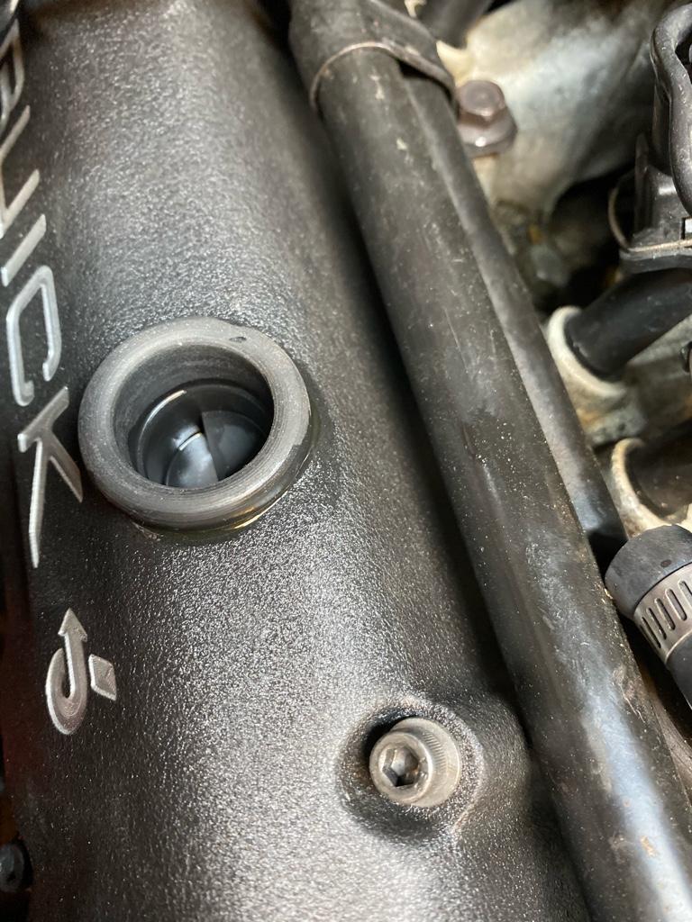

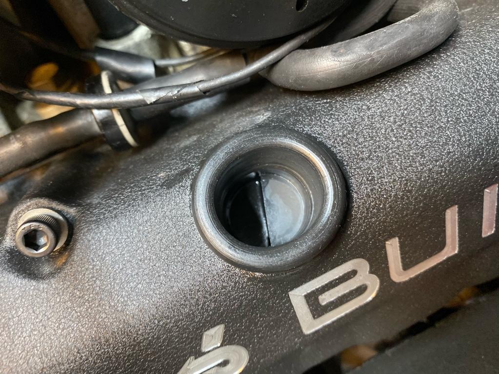

Hard to see: Does the grommet inside the VC have a flap (check valve)? If so, cut the check valve (flap) on both sides.
It does have the check valve. So cut it so the grommet is an open “O” all the way through?
I’m hoping that solves the problem like it did for Matt a couple years ago.

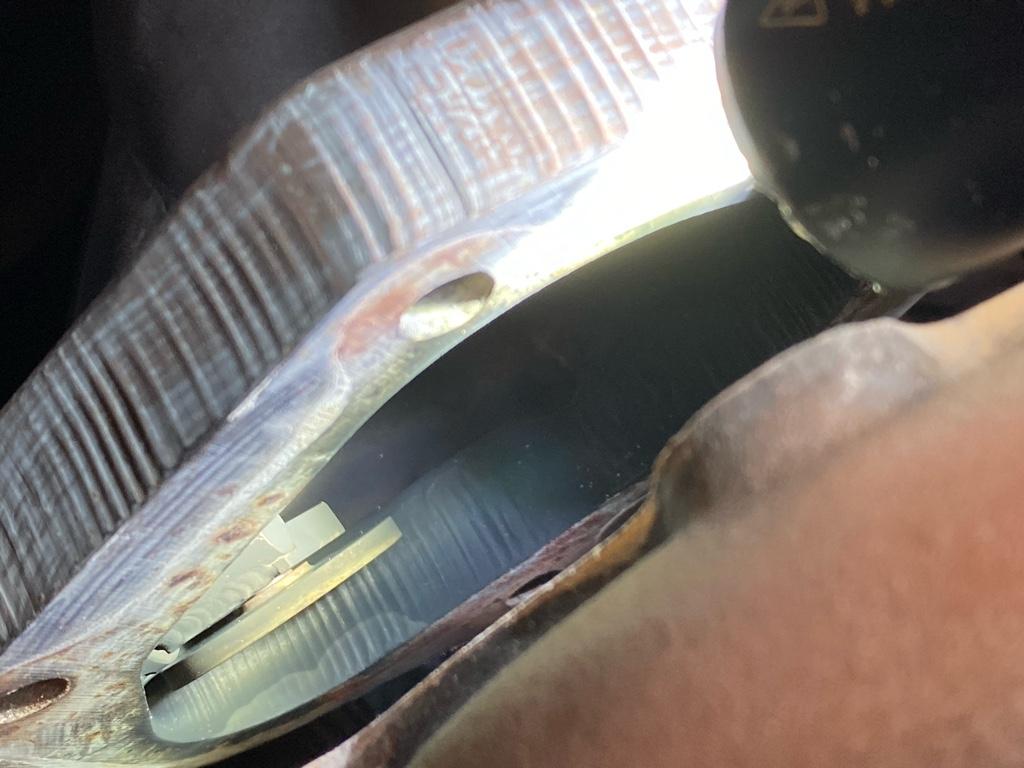

Don't forget to look past the turbine blades for signs of oil as well. It doesn't take much oil to cause smoke. Oil could be leaking inside enough to cause smoke but not enough to oil down the downpipe, yet. Check your thrust. If there is more than .0015" then that might be your problem.
Yes, cut it.

As best as I can tell there’s none in there. There doesn’t appear to be even the slightest bit of play in the turbine shaft either.
FYI.....Mine didn’t either. Zero signs of a problem

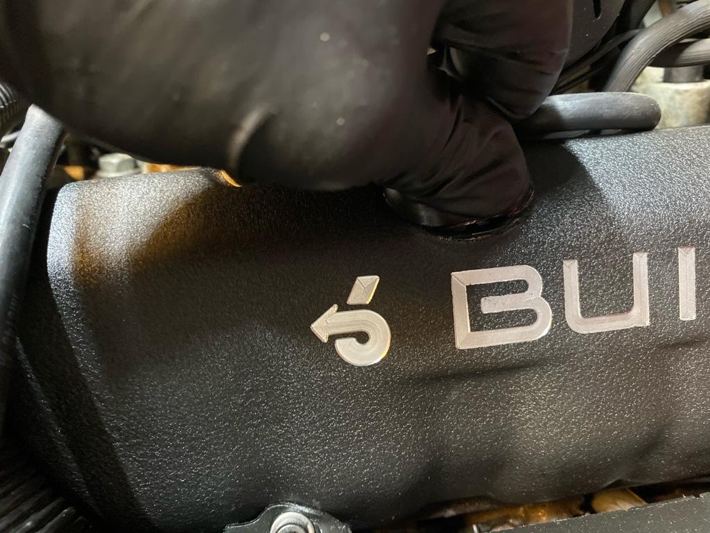

So I went out and on the first few passes things seemed good.
After a few hard passes it smoked although less than before.
Before I went out I wiped a bunch of oil off the drivers side plug wires and steering shaft. After those passes I pulled over and noticed some smoke from under the hood and lo and behold those areas were freshly oiled and smoke was coming from the headers and crossover. I’m guessing maybe under boost oil is spraying out hard enough from the valve cover gaskets to hit the exhaust/headers and other hot parts to cause a big cloud of smoke?

Regardless, with the oil splashing out of those valve covers, an intake leak and engine leak down test may be a good idea.
Just went through this with the 87. After a WOT blast, oil would spray the drivers side header and make a smoke show. Turned out to be that the breathers the PO installed were too restrictive. They were the dome shaped breathers with a bunch of small holes along the underside. Replaced them with open element breathers and the problem was solved. Also pinched the oil dipstick so it would hold a little better on the tube as there was a little seepage(but not enough to warrant all the smoke).
