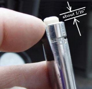

OK, I've taken the console out and noticed that the 1/16" plunger height is too much and forces the locking rectangle locking pin to go too far down and it gets out of it's slot. Here's a pic in a sec.
