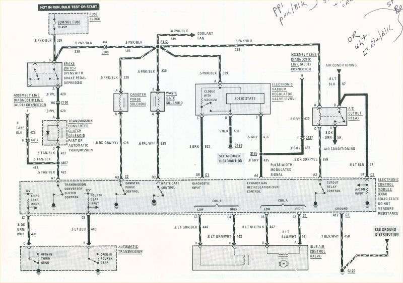

Look at this circuit diagram: If you understand circuit diagrams, you may cut to the chase and check it out without going thru my suggested routine below.
The lock up circuit is on the left side of the above circuit diagram. Power comes from the ECM-SOL fuse in the fuse block and goes to one of the brake switches mounted against the front edge of the brake pedal arm. It comes through the switch and goes to the connector on the side of the transmission under the car. Inside the tranny it goes to the tcc solenoid and then returns back thru the connector to the ECM which controls the lock up and unlock by grounding the circuit.
