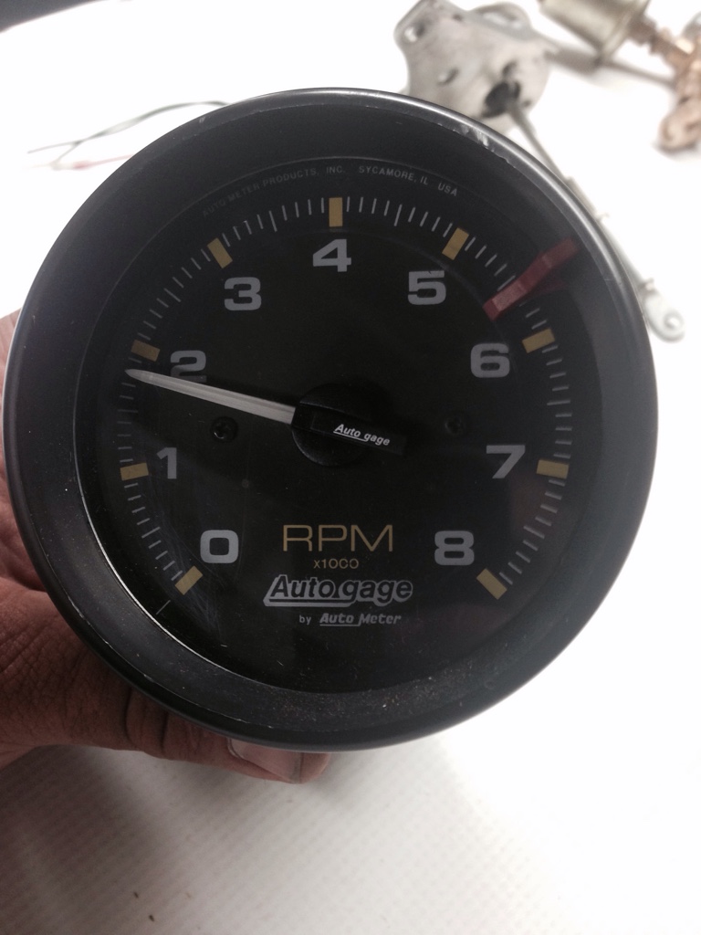

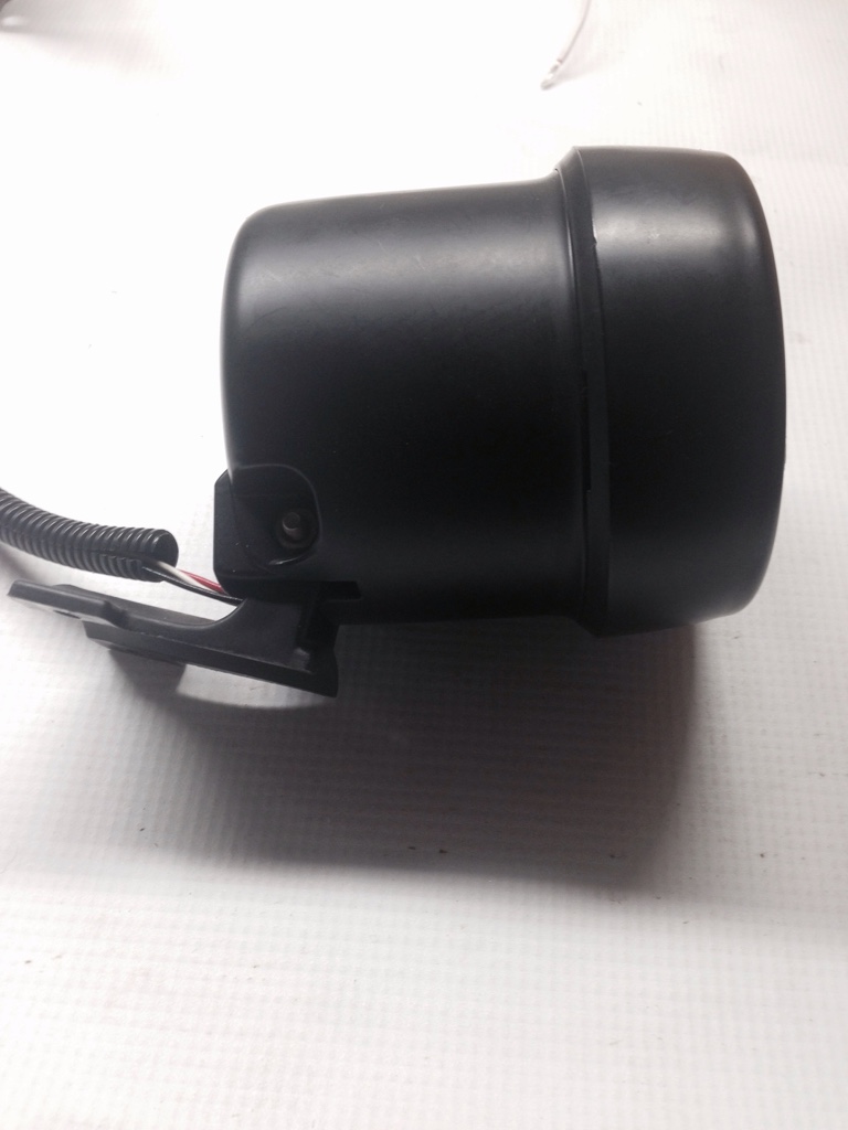

I have this Tach for sale just came out of my car $40 plus shipping.
