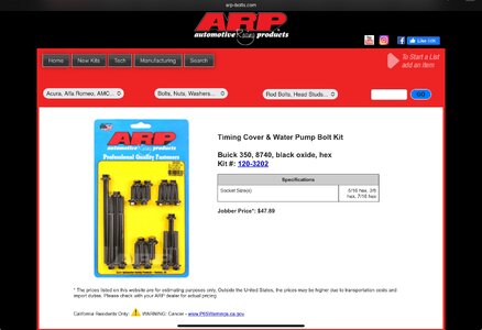

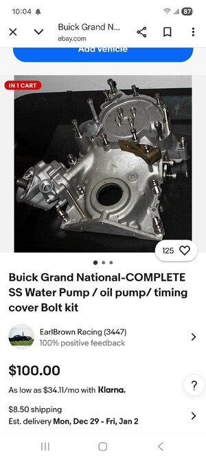

Hey everyone I’m replacing my water pump does anyone make a new bolt kit for water pumps ?
Try to contact him here first
T/A has them in black and they are ARP # 120-3202. The Buick 350 is the same. Just an option if you want a factory look .

I am not a fan of the stainless shiny look so i went with is kit ARP # 120-3202, looks more stock and is exactly the same.
