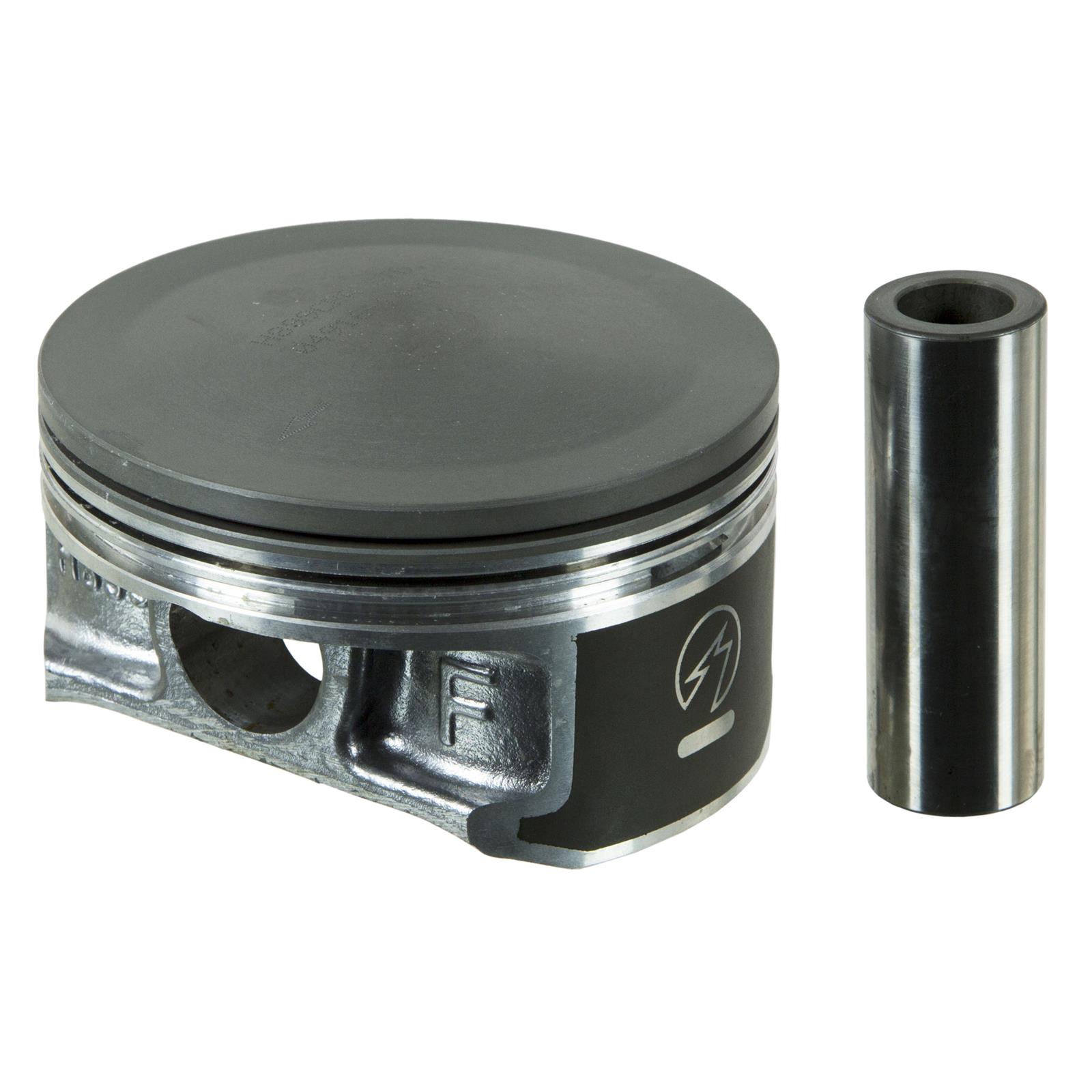

Anyone know what these are? Google pulls up nothing. I know they’re a forged trw but that’s it. 648-99
I used them in an engine I had with zero issues. I always had the rotating assemblies balanced in my engines.
What Turbo Archie said plus they have a lower compression height because they anticipate you cutting down the decks to achieve your desired compression ratio. I didn't know this years ago when I rebuilt my original engine and just installed them without measuring anything. When I removed the engine to install my current engine, I measured the combustion chamber volume and how far down in the bores they were and discovered that my static compression ratio was 7.88 to 1. The correct way to chose pistons is to do all the machine work first then order custom pistons that will allow you to achieve your desired compression ratio while removing a minimum amount of material from the decks to keep them as strong as possible..
