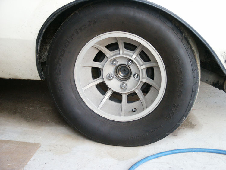

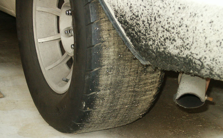

in the rear with out rubbing i can run 275/60R15's
if i take a hard corner it will rub alittle
This is close ups of 275/60's.
Here is an old picture from the 90's with 275/50's. You can see the bulge is a little more than with the 60's because the 50's are wider and 2" shorter than the 60's.
The 60's rub the frame less than the 50's and work best on stock T Wheels between the two.
