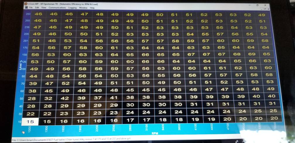

Why, does it look crazy? I was just helping someone else with a table and it converted very crazy looking on my end.
Is there a trick to saving or opening tune files?
This is how it should appear
Sent from my SM-N950U using Tapatalk
Looks very different.
Not rocket science right? Save all tables, email same. What extension should it have? This forum would not allow me to load as it was in Fast

Love this car. 90 degrees outside and it
shitsngits. This did the trick, thanks Mr. Spool. I'm actually hitting 292kpa now so I need to tone it down a little. I guess fast just copies the last row for the next level up and in my case added 25% more fuel to make up for it??
:)boost with fuel and octane usually is a good time.

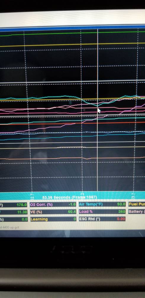

Fuel pressure is dipping, 6lbs (this pic) in all my runs. And, it seems erratic to me even with normal driving. However it looks smoother when fast is not bouncing around various cells.
New TT255, filter, hotwire. I dont know the condition of this blue fp regulator.
I'm going to run a dedicated ground to the battery first.
test voltage at the pump and i hope your running a volt booster
The ground fixed the dip, and I'll put the volt booster back in. I thought it would make tuning the meth more difficult so I unplugged it.
