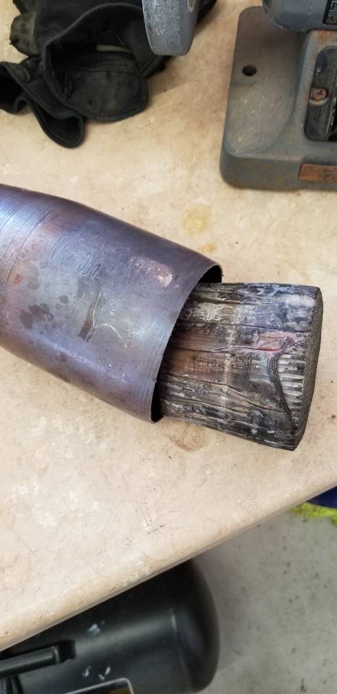

Dumb question maybe but what the hell is that?
Not at all. Supposed to be a high flow cat. Took it off today and that's the media or whatever it's called, bouncing around inside.

No more kr with that thing gone, but still have the new noise. Something up with one cylinder, making a noise almost like a exhaust leak but it's not.

Looks like a block of wood.... weird but I guess I never looked inside a converter
