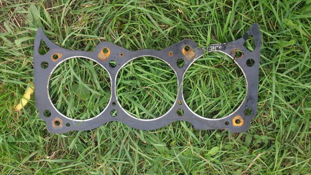

No effects of lots of octane. We run 8:1 comp 21psi and 14 degrees timing was enough for 450rwhp and 10.80s on the 1/4 .have had boost at 35 on the same timing with no extra fuel when the boost controller jammed and we free boosted no knock lol .
We then lost the map signal when the hose blew off at 30psi at half track and blew cylinder 1 headgasket not surprising when 2/3rds of the fueling instantly disappears lol.time for another $13 gasket or 2 and the max ported iron heads to go on
