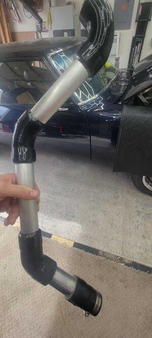

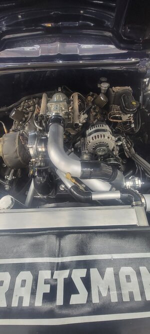

Anybody else using Gates Power Grip clamps? They are amazing and a great alternative if you dont have access to a tig. Just built this upper radiator hose.
