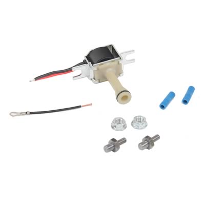

swapped out the tcc solenoid, the one i removed is identical to the one replacing it but i noticed for this jobber part the instructions call for spacer studs to be installed before the solenoid. the old one had none and it's the same jobber part. here is a pic of kit, same idea, those are the spacer studs. i installed the spacer studs, just wondering if having none would contribut to any of my issues??

I'm not sure what not having the Spacers will do. I think the 700R4 doesn't use/require the Spacers. I'm sure someone will know more than I do. :D
