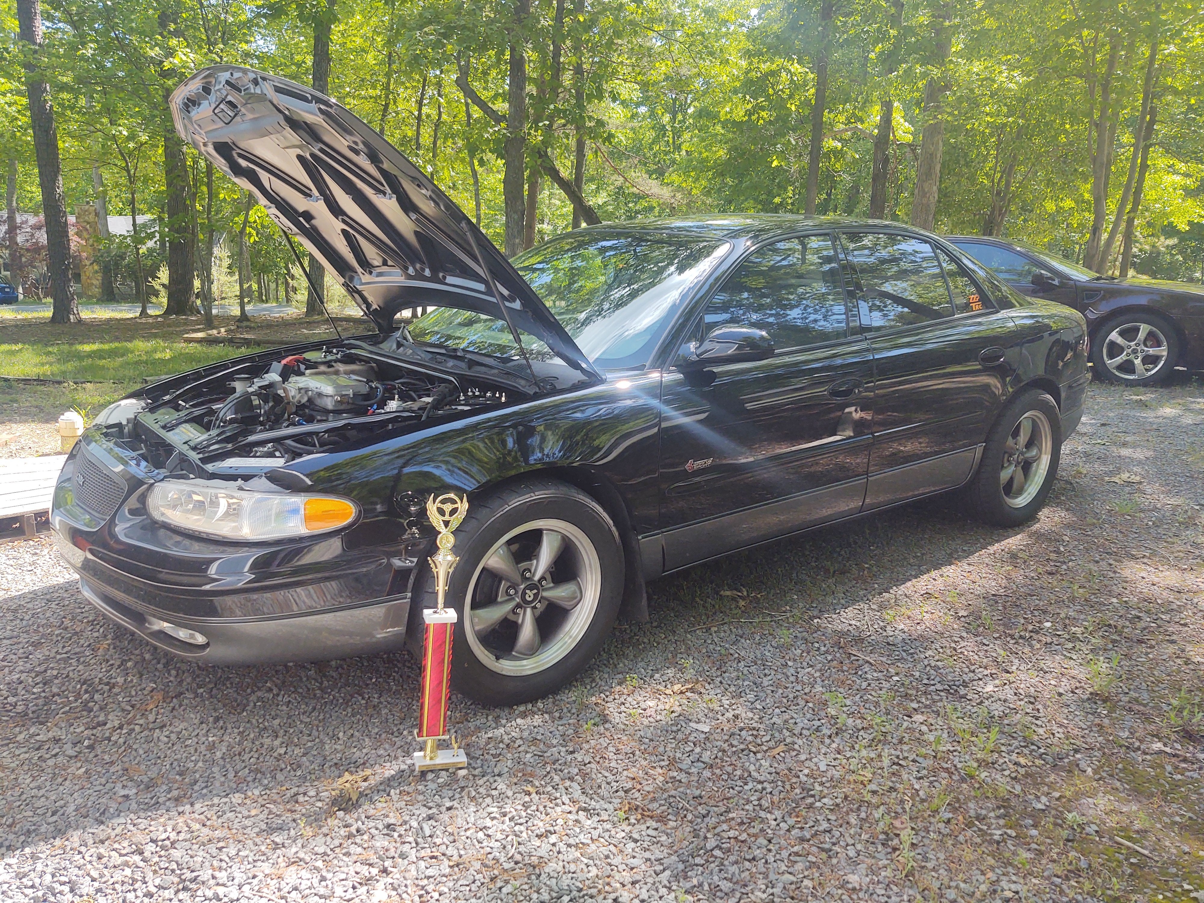

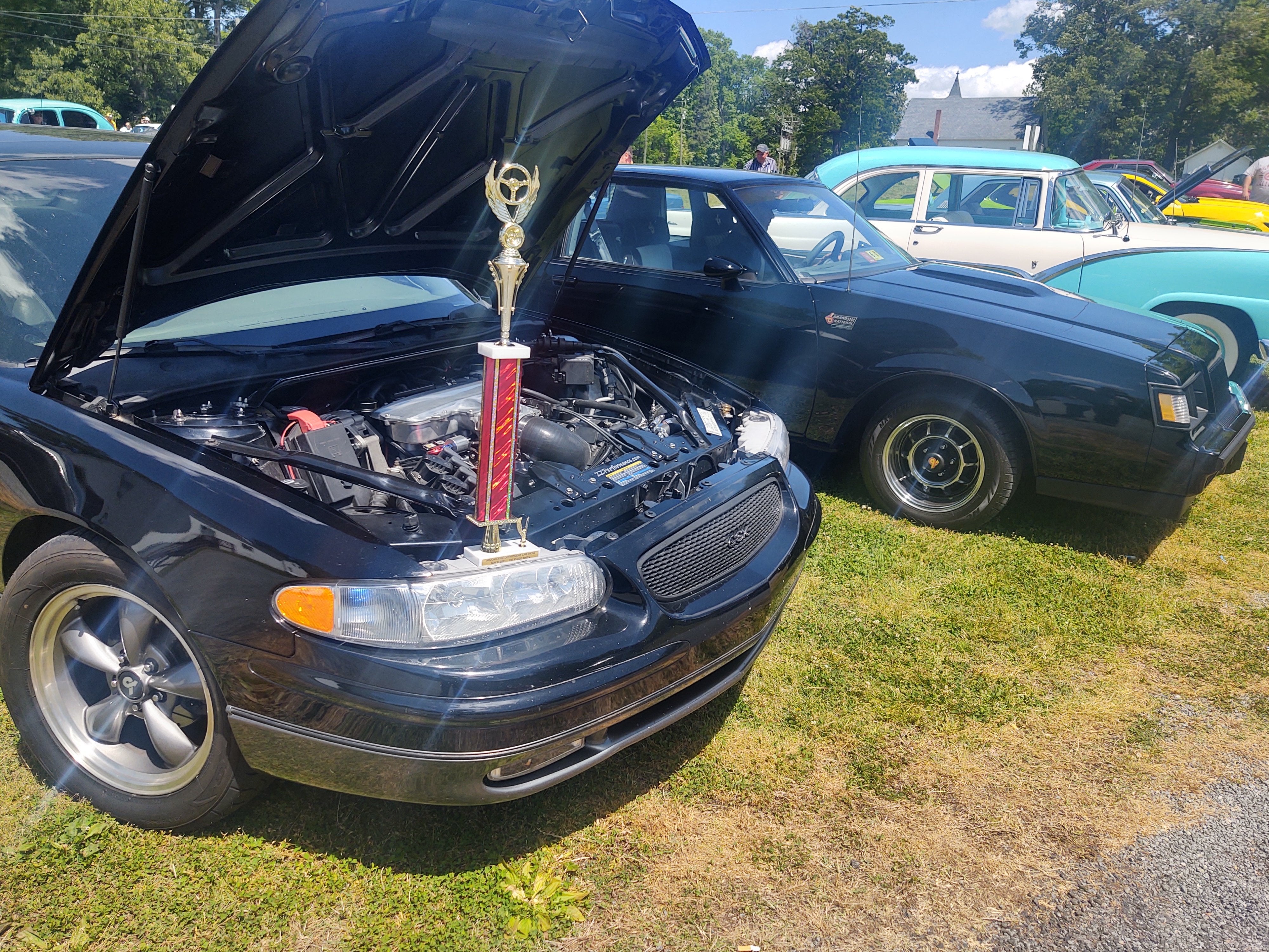

Started the morning headed to a Cars & Coffee, wound up at a local car show & won the 2000's class (2000-2009). That was random! Gotta show up to win, I guess.
Guy with the GN was very nice. I may have gotten recruited to help him on any future mechanical work it needs.
img_20210508_143207216_hdr-jpg.11198
img_20210508_151754087-jpg.11199
(Do all that work to make it go fast, and it gets its 1st trophy sitting still.)
