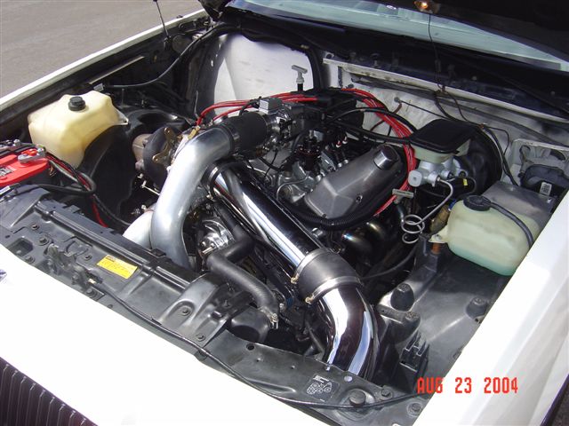

This is where most people get their kits from.
MAF/INLET Pipes
4" INLET Pipes
I currently run the 4" kit on my car. Good stuff and I do recommend TR Custom Parts.
For cars without MAF sensor, (FAST XFI, BS3 DFI etc etc.) this is the setup you would want.
HTH
Patrick
Another source is RJC. Jason and company make a real nice 4in polished aluminum pipe, this too is for guys not running the MAF anymore like myself. The fit and finish is excellent.

thanks alot for the photos.
I know what you're getting at, but honestly, I don't believe anyone has ever done that much testing / homework with our specific application. In the Turbo Buick community, testing has always been done pretty much by seat of the pants, at a dyno or at the track. (hp vs mph differences before and after type testing)
I can tell you from personal experience, that moving the air filter down low helps to significantly lower inlet air temps vs pulling in hot underhood air coming from the radiator and fan, with the cone filter attached to the MAF pipe. I have run both setups. 3" MAF with filter attached to the MAF sensor, 3" MAF pipe with filter down low, 4" filter attached directly to the inlet pipe and now 4" setup with filter down low. I can tell a difference in spool up as well as inlet charge temps with the 4" setup. And some will say that it does nothing going with the 4" stuff and running a stock MAF, but I beg to differ. I have seen gains going from 3" to 4" and still running the stock MAF. Even with only running one screen in the MAF. Some may say it's over kill, but I like the 4" piping on cars that run 11.50 and faster. But that's just me.
