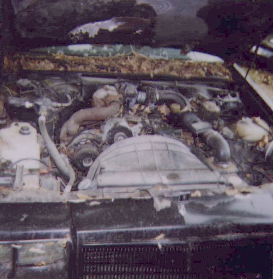

'84 WH1 has set outside for 17 years.

IT RUNS. Ran a bit rough and smokey for about 5 minutes then smoothed out nicely. Guess it's time to put the wrenches away and get the tin snips and wire feed out. I hope the Ford Crown Vic trunk lid that I am using for sheet metal doesn't jinx me. o_O
