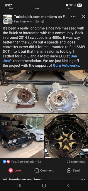

Saw a clip about the 8hp. Is this popular in the turbo buick world? Wondering if anyone put an 8hp in a street machine.

Only a handful. It needs an adapter plate to bolt to our V6, and there aren't a lot of options for a computer to run the gearbox, and what options there are, they're pretty pricey.
And since there aren't a lot of folks doing it, there's very little about how to program the shifts for our engines. It'd be nice if more people would do the conversion and create a market. It's an excellent transmission.
