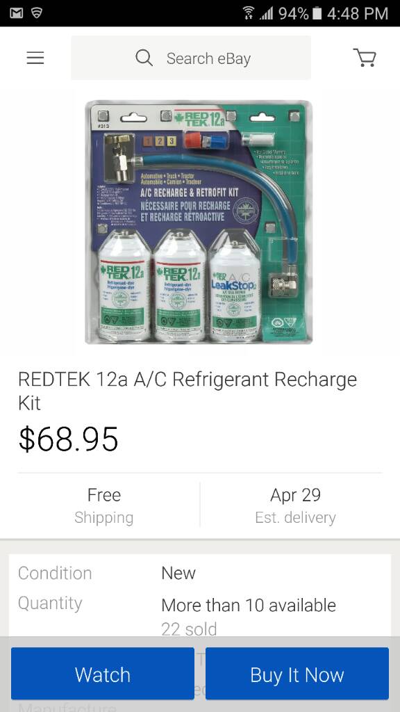

you can find it on flee bay.

Thanks blackazz, that is the exact kit that I bought. I used it today & with the first can the compressor began cycling and AC began to blow cold. I ended up using both cans & now have a working AC system again. I bought more Redtek for future use. Just wanted to let others know that this is a viable solution without spending alot of money on R12 cans that are 20 + years old. Many times I see other members problems but don't see what finally worked for them. Wanted to share that if you have a working R12 system that just needs a charge & don't want to convert to R134 this seems to be a good way to go. Looking forward to driving around in comfort this summer.
So you didn't change the drier,oil. just fill an go right?
Yeah, I did also add the stop leak can for what its worth. Pressure measured out to 42 at low side port. AC blowing cold thou it's only in the 60's in NJ today. Compressor cycling normally, will be a better test when we hit some warmer days in the near future. Thinking about adding oil the next time I need to charge the system.
Nice! Keep us updated,I'm thinking about trying it out to.
