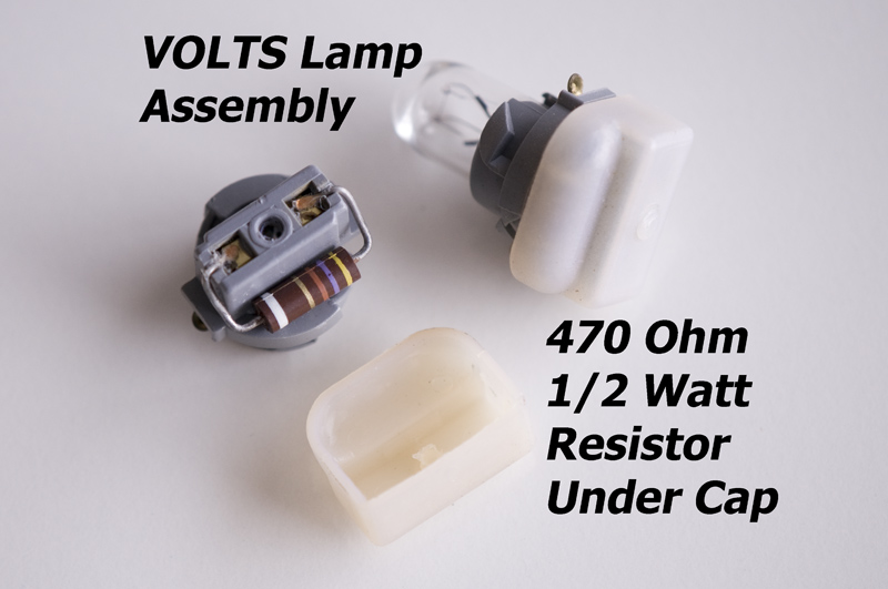

Some cars have both the light and a resistor in parallel. If the bulb burns out it will still charge with that setup. You have to pull the light to see the resistor. More than likely what you have . . . .

the lamp socket has a resistor ...it will charge with a loose or blown bulb
if the socket twisted loose ..no charge

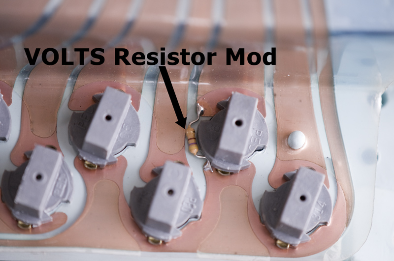

When I repair digital dash clusters, I do this mod to every dash that comes in. Works on both analog and digital cars. It does a great job if the VOLTS bulb should go out.
Here is the optional bulb socket with the resistor. It's found in maybe 15% of all turbo Regals produced.
