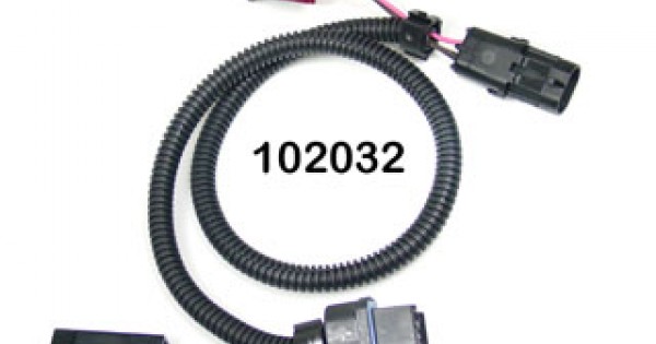

If you wire in the 3 wire regulator connector you will be able to use the LED lamp and the alternator will still charge.
Leaving the LED bulb and installing the field fix kit is the best way to go. The original setup with just the bulb is a disaster: if the bulb burns out or fails to make contact with the film, or the film to dash connection becomes flaky, still end up with a dead battery.
Not so with the field fix installed.

The resistor bulb has worked well for me but I have a field fix in my emergency kit, just in case.

Caspers field fix ordered
