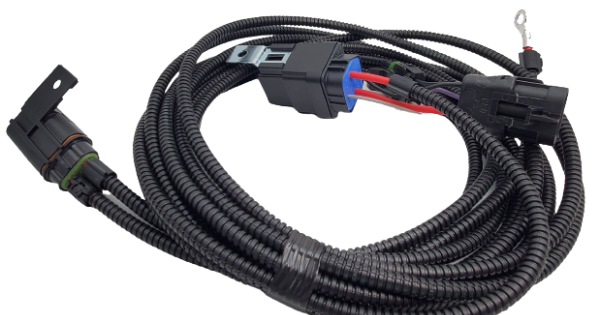

Roger, thanks. And what would you recommend for a hot wire kit? Plugs wires would cause break up at all loads not just down low, correct?

Casper's or Racetronix both make a nice hot wire kit.
Link to Hot wire kit: Fuel Pump Wiring Kit for Turbo Buick (Hotwire)
