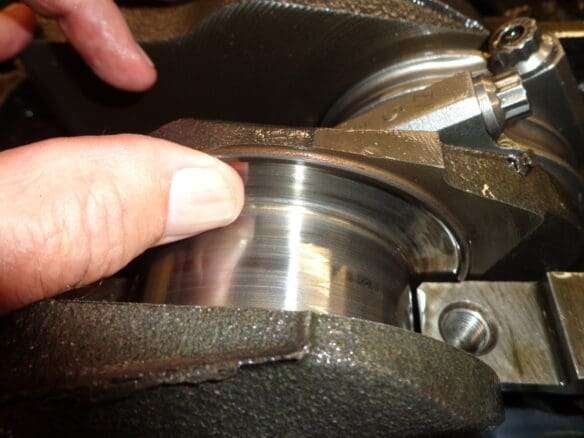

I have found a 109 block all std/std however the crank thrust in the block is damaged. Can this be repaired and if so what options are recommended.

According to other posts it's the crank thrust surface in the block. How that happens I would like to know.
Ahh, crank thrust...ok. Yes, as Chuck noted, if the converter ballooned due to too high line pressure or too high line pressure from a misadjusted TV cable or maybe installer error of a shift kit.
crank thrust bearing failure and in-turn damage to the block can also come from a poor manual polishing of the crank and thrust surface itself and/or errors during setup assembly of the rotating assembly.
As such, like Andrew noted, repairing crank thrust bearing surface in block is welding and machining.

That will eat away the bearing but how does it hurt the block? That's what doesn't make sense. The bearing totally disintegrated and continued to chew up the block? I can't see it getting that bad.
If the thrust bearing spins, it can chew up the main boss.
Now, getting the thrust bearing to spin? Dunno how you do that, but I've broken enough stuff to know anything is possible so I'm not gonna judge.
