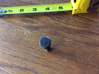

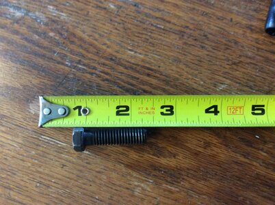

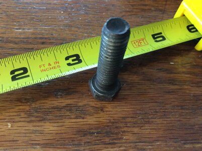

Just found OEM bolt 1 3/8
Thanks all. I had a mix of original and others. I have no idea how I lost some of the originals. I now have all grade 8- 1 1/2" installed.
