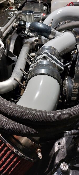

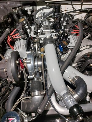

There is a Turbo Buick road course car that plumbed the BO Vv. discharge to turbo inlet to improve response.
in theory the boost controll with a gate or bov on the intake side is going to beat up a turbo pretty good - basically running the turbo full tilt or whatever the exhaust does to the drive... So.. think about this before attempting and/or for the need. .. when you have garrett sending you multiple pairs of turbos to chase a world record - in the case of Micke - this is a different story from the average guy, not class racing and not maxing out th turbo already.

Always wondered if a recirculating BOV like above would play nice with the turbo bearings and hub long term use.
The sudden pssshh of compressed air pushing or forcing itself on the inlet compressor blade n shaft just seems odd while
turbo isn't under positive load (throttle off condition opening the bov). But I don't build them I just buy them, I'll ask the comp
guys next time I see them.
