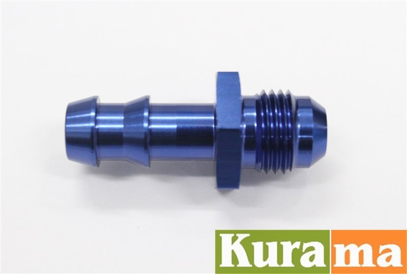

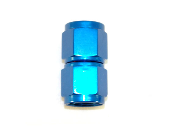

Maybe you can cut your teflon hose and run a slide in male/male adapter
2 of these and then a FM/FM fitting to join them
