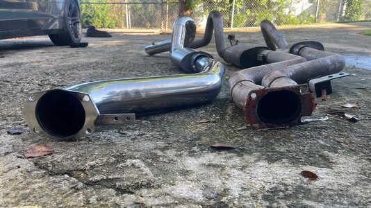

The factory support bracket did not work with the RJC 4" single shot on my TurboT. Instead, I welded a metal strap to the trans xmember. Then, used a universal rubber exhaust hanger from this strap to a bolt on the downpipe flange.

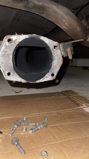

For those looking for a comparison of the 4 bolt flanges
