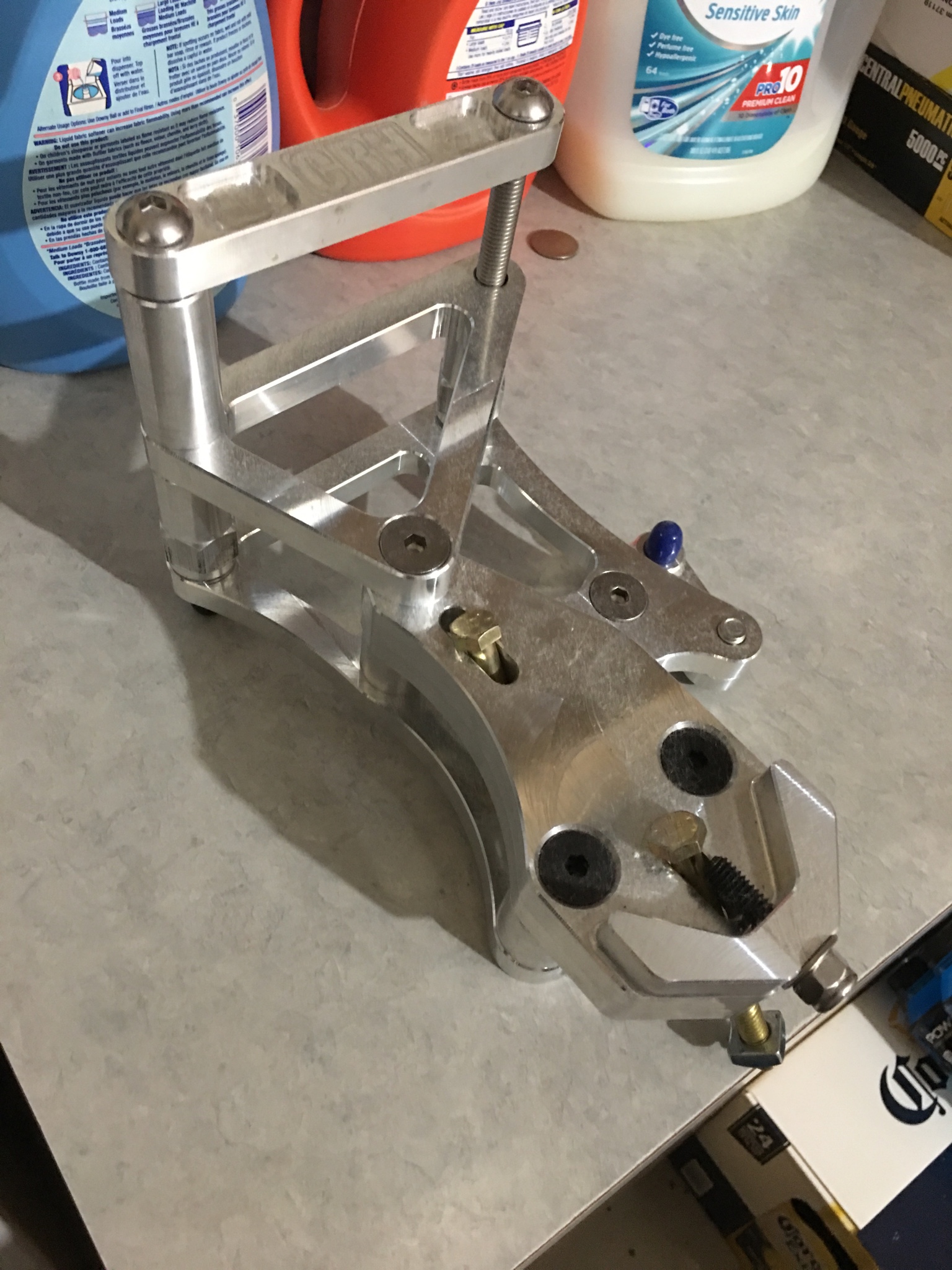

Hey guys, need some help here. I got a champion power steering/ alt bracket. Seems to be missing some hardware. Does anyone have any pics or useful info/ instructions i can use to get something done?
I have stock alternator and power steering- no ac. Cruz pulleys.

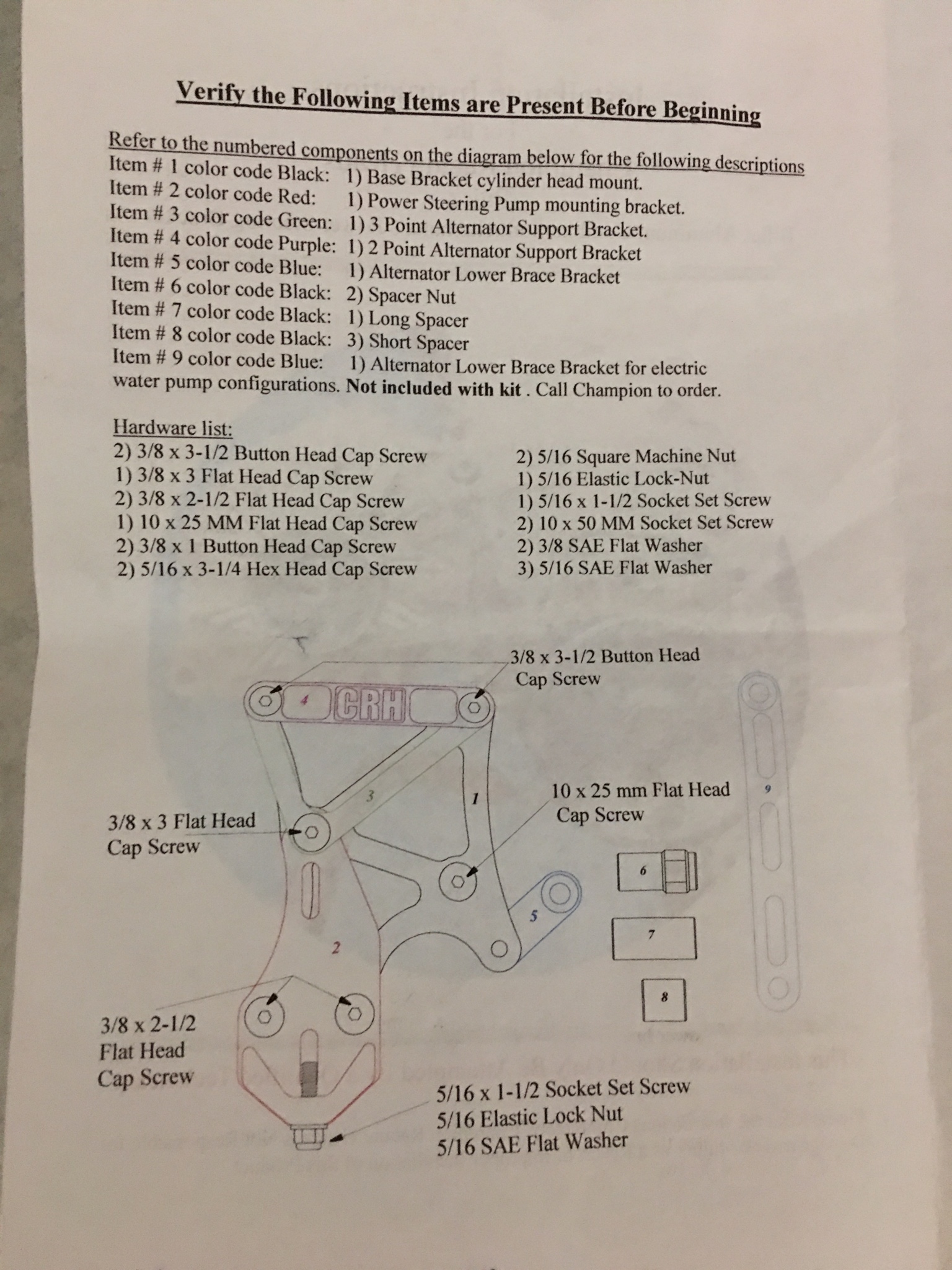

you;re missing a lot of parts
2 studs m10 x 1.5
m10 x 1.5 v head allen bolt
2 alum spacers
one front left hand side alum spacer
2 long bolts and a short bolt for rear of alternator
front bracket and some washers
to hold PS pump you're missing the two long bolts with square nuts

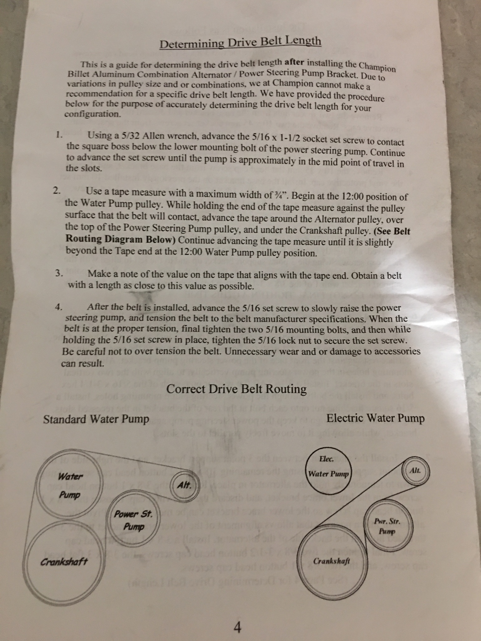

youll also need a 50.5" belt
2 studs go into the head at top (then the bracket slides over studs and one V head allen bolt goe into head at lower hole
2 spacers screw onto studs
then the second bracket lines up with spacers
then youre missing spacer at left and bracket held with a long bolt , then alternator slips in at right side with a long bolt and a short bolt at back

Here are the instructions that came with mine, haven't installed yet
