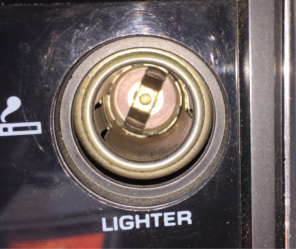

Why is it that every time I plug something into the cig lighter socket the fixes blows???
It's grounded out... pull it out and look at the back IIRC there's like a bent clip thing.... make sure it's not in contact with the sides . U may have to bend or turn it.... I will go check as soon as I can . Right now my daughter is asleep on my chest. But u will understand when you pull it out
Sent from my iPhone using Tapatalk Pro
Thanks, I think that may be it.
Because of this older design socket it is not compatible with many aftermarket plug castings. IF you have a plastic shell held together by a metal ring at the bullet end it WILL short against those pins above. A piece of tape around the ring will help. I also use an autoresetting breaker that fits in the fuse slot. Best mod I have ever done!
ok - lmk if it works... you can rotate that spring clip so its not contacting the sides or you may have to slightly bend it....but im pretty sure thats what it is.
-aaron
Got it fixed. Just had to reach in there with a small screw driver and bend those two big contacts inward enough to get them off the outer case(ground).
What fuse was it blowing - was it the cig/clock 20 amp fuse? I ask because I am having a similar problem.
Yes, that is the one:
