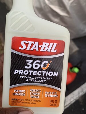

Does anyone have cold starting issues with their E-85 car? It takes a few times to crank over and a few minutes to simmer down before I get this sucker to idle in properly. Once she is there....she is there. Getting her to that point is what I would like to know. Also, what type of fuel additive is good to run with the E-85 to prevent breakdown or "Goo" as others call it?

I use Lucas e85 stabilizer. Are you running a stock or aftermarket ecm?
