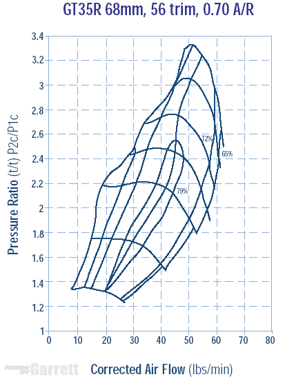

I´m in a great need of the compressor map for the PT-61. I´ve tried to email Precision, but they do not reply.

I believe the PT61 uses the same compressor wheel as the SC61 used in the Precision Sport compact line. (According to Precision's website, they are the same compressor).
When I inquired to Precision over a year ago for a map of the S61, they informed me it was the Garrett GT35R (a.k.a. GT40) wheel and faxed me this map.
This same map has since been publsihed as the following (much clearer map!)
Hmm, looks a little weird to me, but I guess it´s correct. Thank You very much for Your quick answer.
/Andreas

Yes...that map really does have a funky surge line to it.
