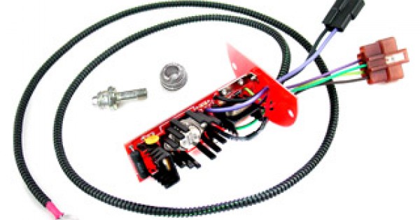

Correct name for this part .
Buckshot G/N
Nov 2, 2011
821
Anyone know the correct GM name for this where screw driver is pointed. Thanks,

Looking at the photo, it appears you have the Touch Climate Control (C68).
This system doesn't have a blower motor relay.
The speed is controlled by the system head and the electronic board in the heater box next to the blower motor.
Look up a wiring diagram for the C68 system. It is different and more complex than the manual C60 system.
Yes I will be working on this problem this weekend, long days at work. This GN does have TCC C68. May I asked how could you tell by looking at photo ?
That connector tells us you have the C68 option. This part is very expensive compared to the $20 blower motor resistor on the C60

The module from Caspers is pricey ($250) but it's a real nice item.
I put one on my car before the stock one failed.
Easy install.
