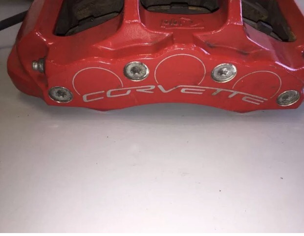

Well, didn't get ctsv calipers, but I did how ever get camaro ss calipers and corvette z06 rotors... Ill update with more spam as my progress goes on

I scraped the whole cts camaro ss calipers and decided to go with corvette z06 and 14 inch rotors... and Im on 20" 3 piece wheels

Blazer spindles, calipers for now I only have the left side its pretty hard to get them and at a decent price. And both OEM rotors I was going to go with the KORE3 bracket.... what do yours look like and do fit without further modification? How much kore3 kit runs for 130
